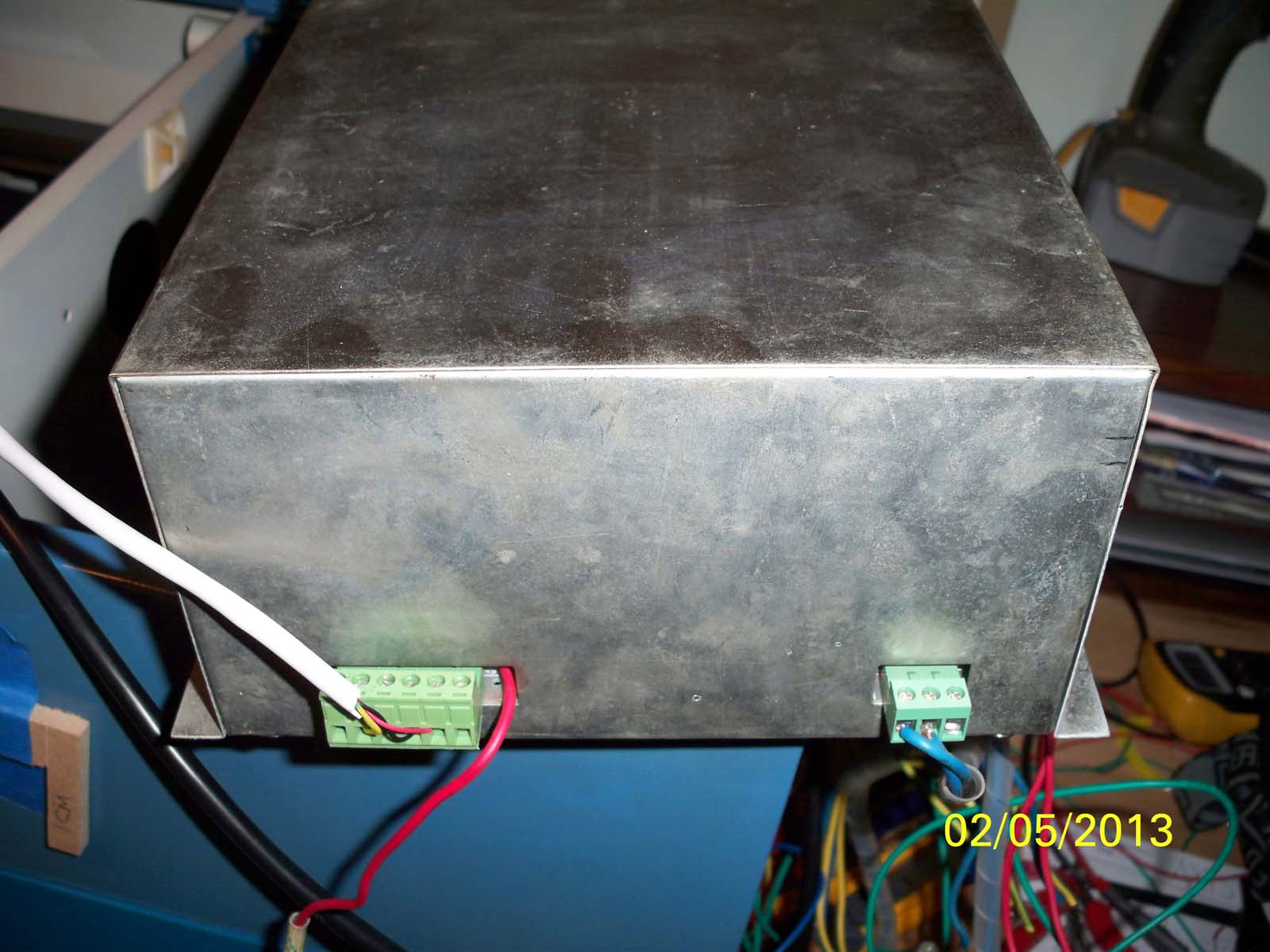

Can I use this Power Supply with the DSP Conversion? The Contacts have no labels or markings e.g TH,TL...
Re: Correct type Power Supply?
Look like OK.
The terminals should be arranged like this:
TH TL WP GND IN +5V
If you tide TL, WP to the ground and +5V to the IN, it should fire in 100%

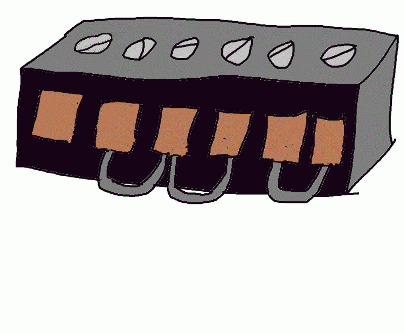

Tie like this?
Yes. But I'll add a push button switch between "TL" and the "GND". That way, you can manual control it On or Off by the button switch

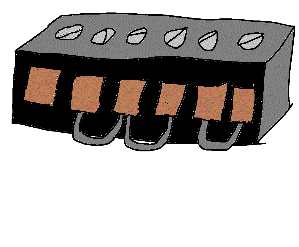

Like this? And what will this button control?
No, that is no difference at all.
Break the connection on #2,#3 (counting from Left to Right) then add a push button

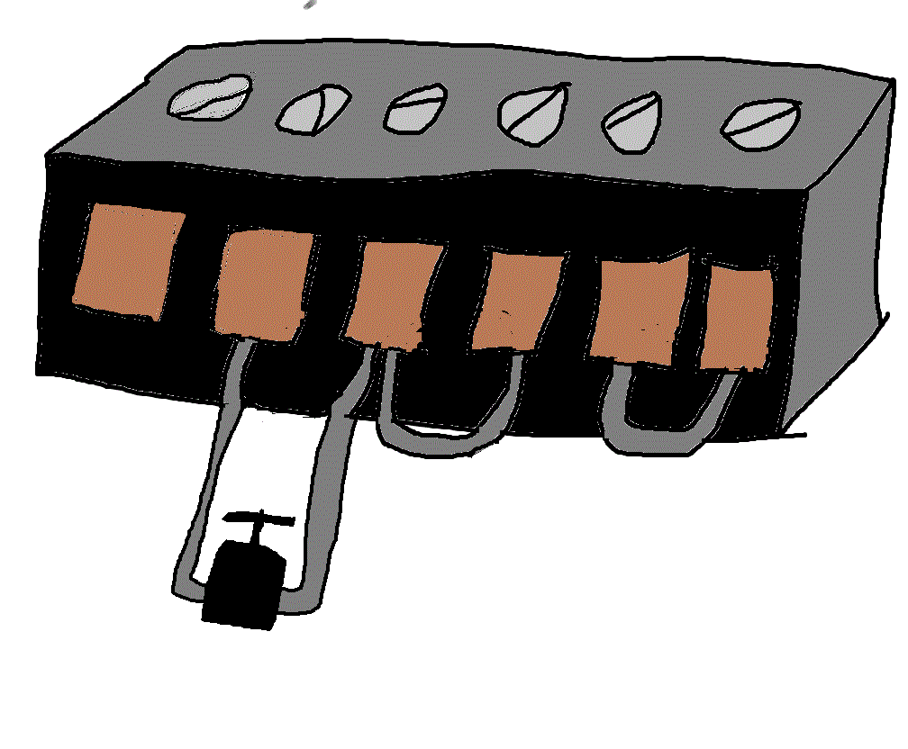

Post by wrench »

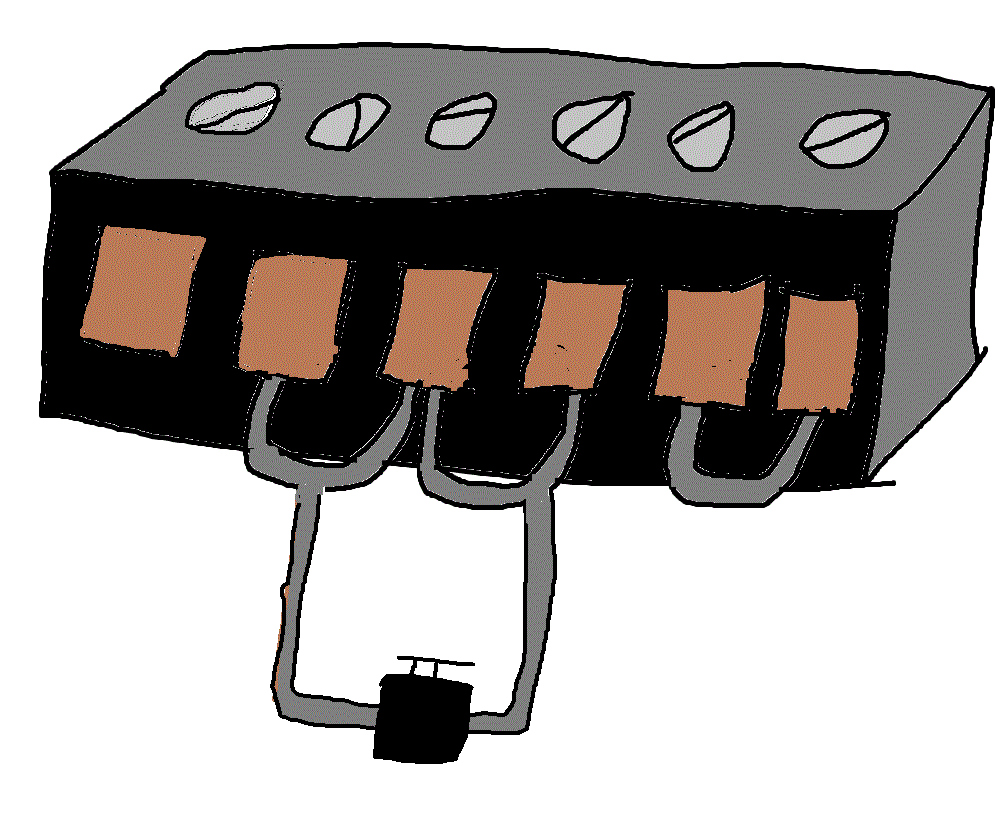

Like this?
You got it

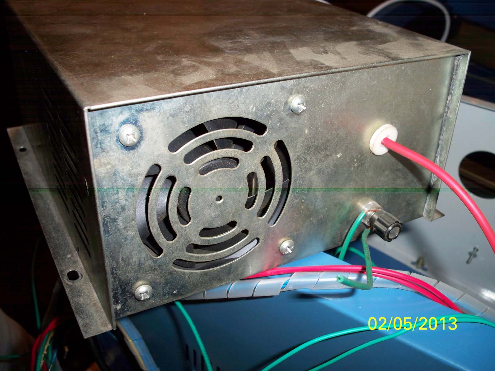

In my first post on this thread I posted three pictures of my Power Supply.
The second picture show a big RED cable that goes to the tube.
The third picture shows a smaller RED cable that I think went to the old analogue gauge. Where does this wire go to now?
