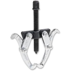

Re: K40 mini rotary. Higher quality made
You need to use a special tool to remove the pulley similar to this one: http://ecx.images-amazon.com/images/I/3 ... SY300_.jpg
We customized a few and asked if anyone interested. But seems no one interested so I didn't order. When you try to put back a pulley, make sure you have to use a vise and a support to the shaft end is NECESSARY. Otherwise, you will damage the motor if you try very hard to push a pulley into the shaft
