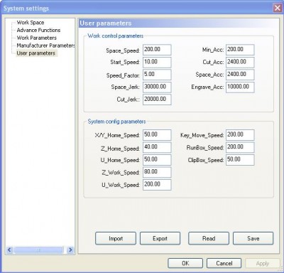

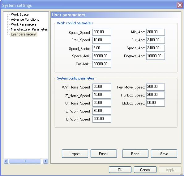

Here are a couple of Screen Grabs of what has changed.
As you can see there is no mention of any AIR assist or likewise. The new manual really does need to be released soon for all those poor unfortunates that have never set one of these up before. I have done it a fair bit and I still had a lot of trouble. (especially with the limits!)

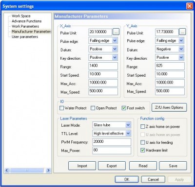

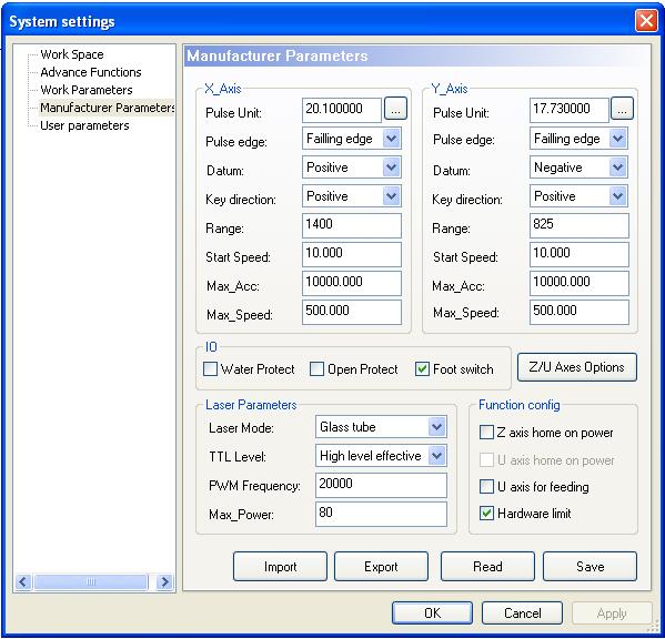

We still have the old problem of having to change the datum direction every time we want to raise the table if we haven't taken it back to where it was before the machine was shut down. I REALLY wish I could disable the soft limits on the Z axis and just be able to drive it up or down without having to keep swapping the origin direction every time it reaches the limits. If you forget to drive the table back to the setting you started with when you first start up the laser then you have to go through that whole set up process every time. I just don't like the whole implementation of it. I don't think this can be changed as it's integral to the whole system. I briefly tried the U axis but I will save that for another rainy day when I get the rest of it sorted out.
The limits still don't work! if I select Hardware limits then I can't move the table any direction in X or Y. If I press reset (before the LCD screen pooped itself) the gantry moves about 1mm then stops. I have changed the motor wires around hoping that may be the trouble but it's not. I can't find the section in the manual or on this forum that Marco is talking about where you set up the soft and hard limits.
The only other thing I can do now is to swap out all the NC limit switches with NO ones and see if that works.

I had another look at the Limits today and found a couple of things.
The limits were marked wrong on the DSP. I didn't think it made sense.!
My machine is "left up" for the "Machine Zero" and "Left Down" for the "Job Zero" and that way I can use the adjustable limit stop on the X axis
I have them marked like this now:-
1 24V
2 Y-
3 X+
4 Y+
5 X-
6 GND
I have the other setting like this
X Datum = Negative X Key Dir = Neg
Y Datum = Negative Y Key Dir = Positive
The table axis are like this -
.............. Y-
........X-....O.....X+
...............Y+
Sorry about all the dots but that is the only way I could get the letters to pad out to where I wanted them.
The Range is 800mm x 800mm for my table work area at the moment and I can increase or decrease it any time I want but that is a good envelope to work in.
Start speed is 10.0
Max acc is 10,000
Max Speed is 1500mm/s
If the motors turn the wrong way then you need to swap over 2 wires (A,A+ or B,B+) to change direction. Please do turn off the power to the drives when you do this as some drives will destroy themselves if one of the wires is off and the power is on.
You also need to have NO limit switches. NC ones won't do the job and you will get a "Trigger Limits" message because the switches are closed. I didn't have any luck with the "High" setting trying to get these right so just use NO switches and set "Low Pulse" in the software.
The limits set up is where I always have to biggest problem with the DSP set up because there are so many different ways to connect them. This has taken me 2 days to sort out but mainly due to the wrong labeling throwing me off. It was marked by hand with a felt tip marker from someone but it was still wrong. ( I think it was anyway as it all works now)
I have 4 limits, one on each side of the gantry.
I set the "Home/Reset" speed to about 10 or something equally slow for your machine and then pressed "Reset". As the gantry was homing slowly I was able to press each individual limit to see if that was the one the DSP was looking for. This was the only way I could find which limit was the right one and how I found out the labeling was wrong. Phew! It really takes some time, sometimes!
I hope this helps some people out there with their set up.
Every thing is now working as it should (except for the air assist but I will tackle that later)
I pressed the LASER button on the LCD screen and the laser fired and stayed on again. I had to press RESET to stop it. It's not in my wiring!
My old board did this as well.
I'm happy things are working now and I just need to iron out a few problems but they don't stop me using the laser though. It runs VERY well.
Rich
