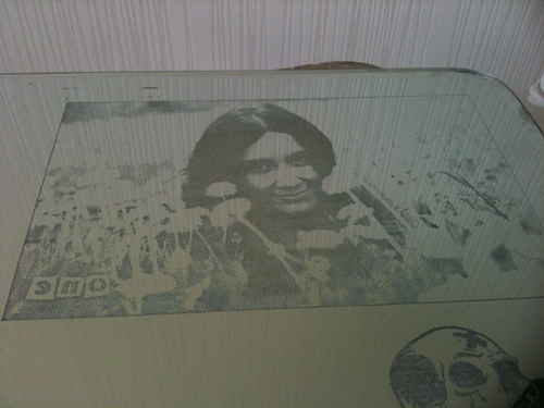

Hey guys!
Here is my todays portrait engraving try. This was made on back side of mirror. Looks much better than my other previous attemp, but if you look at mirror straight, at 90 angle, it does not looks so good as looking from side. Anyway, good result.
Macro, please set max image size at least 1000px, 500px is too few.
