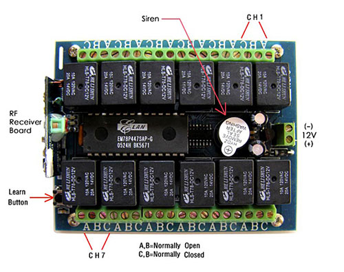

12Channel RF controller Programming Instruction
(This receiver can take up to 8 transmitters)
Erase memory:
- Press and hold the learning button till 6 beeps and all memory will be erased
Receiver training:
-Momentary:
o Press and hold for 1s until a beep is hearing. Then release the button
o Press button “1” immediately on the remote unit and buzzer beeps 3 times
o Completed
-Latched (self latched until a button other than itself is press will disengage the latching):
o Press button “2” immediately on the remote unit and buzzer beeps 3 times
o Completed
-Toggle (Press=On, Press again=Off):
o Press button “3” immediately on the remote unit and buzzer beeps 3 times
o Completed
-Dual mode (1-6 Momentary, 7-12 latched):
o Press button “4” immediately on the remote unit and buzzer beeps 3 times
o Completed
-Dual mode (1-10 Momentary, 7-12 latched):
o Press button “5” immediately on the remote unit and buzzer beeps 3 times
o Completed
Specification:
-Operating voltage: 12V
-Frequency: 433MHz
-Idle current: 6mA
-Sensitivity: -105db
-Output: Relay
-Relay type: 6A
-Size: 97mm x 77mm x 26mm
